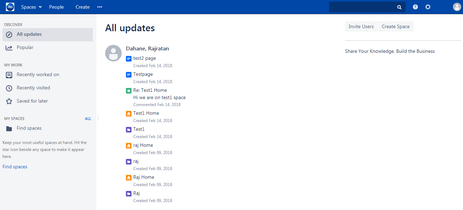

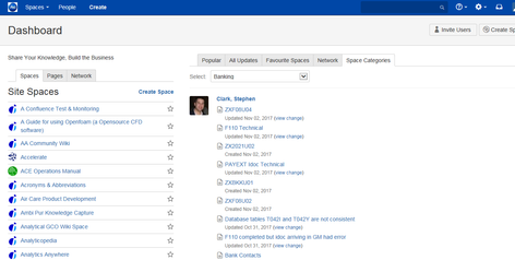

Rajratan Dahane
February 23, 2018
Hi,
we have upgraded Confluence585 to Confluence670
but dashboard is not looking like confluence585.
could any one help us how to make custom changes so that it looks like Confluence585 dashboard.
we are attaching both dashboard screen shot,
Following is Confluence v670 dashboard screenshotConfluence v670 home page.png

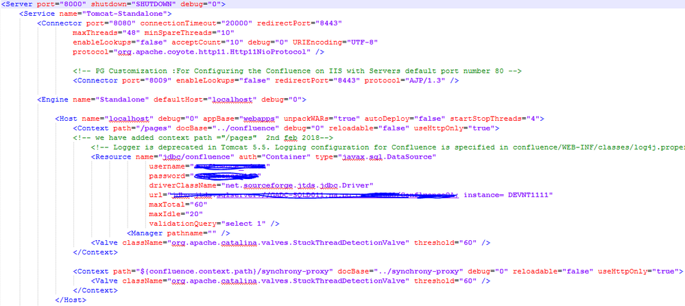

Rajratan Dahane
February 12, 2018
sure
Please find the below screenshot of server.xml
Nic Brough -Adaptavist-
February 12, 2018
Ok, that confirms the port.  As you have no proxy or ssl set up, then you are looking in the wrong place for the service.
Your access url should be http://inetwikiqa.pg.com:8080/pages  (note - NOT https)
