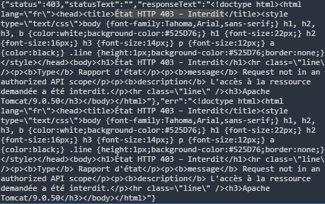

Hi . i wanna get email adresse for a specific user by accountId and i have a 403 error
getEmailUser(accountId) {
let url = this.config.apiPath + "/user/bulk?accountId=" + accountId;
return AP.request({
url : "/rest/api/user/bulk?accountId="+accountId,
             contentType: "application/json",
type: 'GET',
             Authorization: "bWJvdWF6emEuc3BlY3RydW1ncm91cGVAZ21haWwuY29tOnd6UGhpRXBWd1JTN0E0aDhrRVRyODhGRg==",
        }).then(function (data) {
            console.log(data)
return JSON.parse(data);
        }).catch(function (error) {
console.log('error email user => ' + JSON.stringify(error))
 i tied this url : wiki/rest/api/user/email?accountId={accountId}
and it return the same error

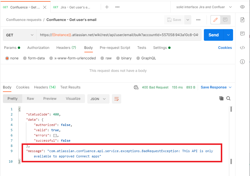

Even if you do fix the mistake in your code and send a properly formed request to that REST API endpoint and use the appropriate permissions, it will just return a 400 Bad Request response with the message:
com.atlassian.confluence.api.service.exceptions.BadRequestException:
This API is only available to approved Connect apps
...because the documentation for that endpoint specifically says it "Returns user email addresses for a set of accountIds. This API is only available to apps approved by Atlassian, according to these guidelines." and your code does not meet the criteria described in those guidelines.
If you use a REST API test tool like Postman, as I've recommended you do in other posts elsewhere, you would have discovered that all this is true:
I think you should spend some more time reading the documentation on how to use the REST API, what the different response codes indicate, and testing your code to see if you are sending a valid and correctly authenticated request place in the first instance.

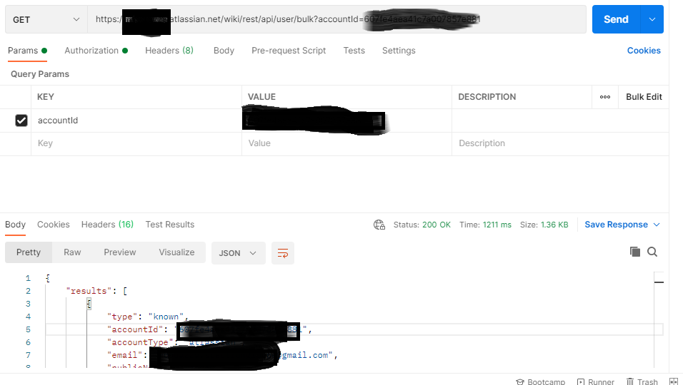

when i use the same url on browser or postman , they send me the result i wanted
