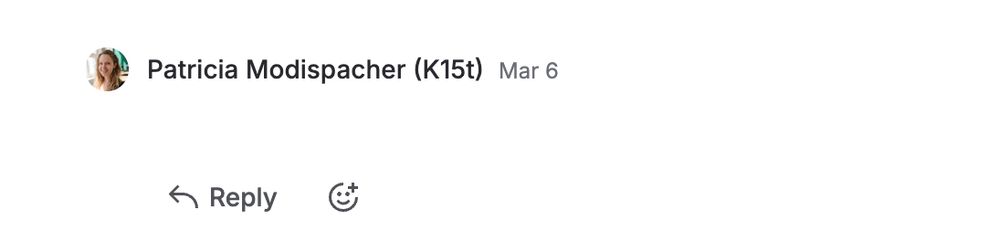

The agent itself worked great when I tested it directly. The audit output was exactly what I wanted. So I wired it up in Confluence automation, tested it… and nothing. Literally, a blank page comment:empty comment.jpg

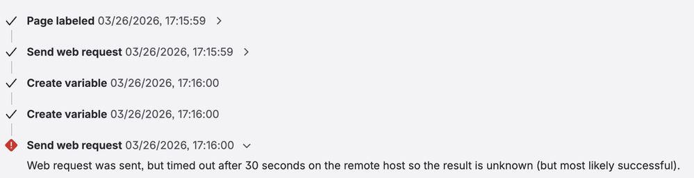

Then I noticed this message in the automation audit log:
30 seconds. That was the key.
⏱️ The 30-second wall: a known platform limit
Confluence Cloud automation's "Send web request" action currently has a fixed 30-second timeout. This is not a setting you can change today. Atlassian has an open suggestion requesting a configurable timeout, which confirms that the current limit is fixed. If the endpoint takes longer than 30 seconds, the automation can time out and return a message saying the result is unknown.

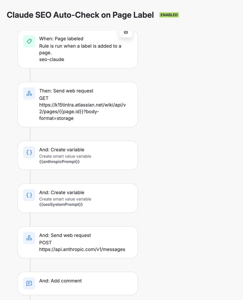

πŸ’‘ Where I've landed (not a perfect fix yet)
The first thing I tried was simplifying my prompt. I stripped it down to almost nothing β€” just enough to call the agent. It worked… but the output was useless. A shallow, generic audit that missed everything I actually cared about. So that wasn't a real solution.
What I ended up doing is moving the system prompt into variables β€” {{anthropicPrompt}} and {{seoSystemPrompt}} β€” and keeping the request body as light as possible. That combination gets the request through within the 30-second window.
It works. But it comes with a real tradeoff: the lighter the prompt, the shallower the audit. I'm essentially tuning the instructions to fit a time constraint rather than to produce the best output. That's the part I haven't fully solved yet.
