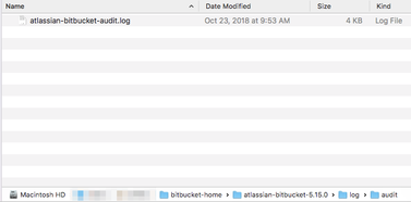

Example:
Please note these audit logs are not available through the web UI of BitBucket.
I hope this clarifies how to access the BitBucket audit logs.
