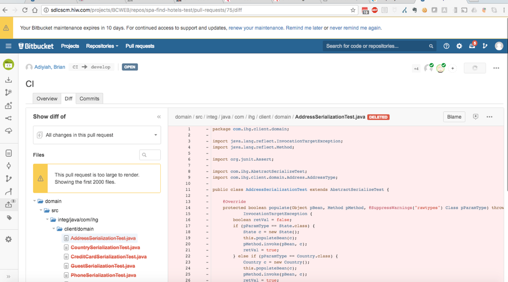

BB1.pngHey Ana, he is able to connect to the server. thats is not the issue here is a screen shot.. when he tries to merge this repo its happening, do we need to reduce the size ???
-Prashanth
