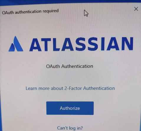

- a Bitbucket pop-up will pop and ask for the app-password.
- then it will open a webpage inviting you to login to Bitbucket with your main account/password.
Finally, if you do this, you might think Git will use the app-password when interracting with Bitbucket. But no : it uses your main credential !
This why revoking the app-password won't change anything.

It looks that the credential manager is prompting you to trigger OAuth authentication.
If you're using the following credential manager:
I can see there is a setting available for authentication modes when using Bitbucket:
Do you see any setting for credential.bitbucketAuthModes when you run git config -l ?
You can try setting this to basic only and see if you are then prompted to enter a password.

- a popup asks for the app-password (note : I cannot write a wrong password here. It needs to be the right app-password.)
- I am then invited to provide my Bitbucket login/passwd :
==> I quited the last step by closing the window.

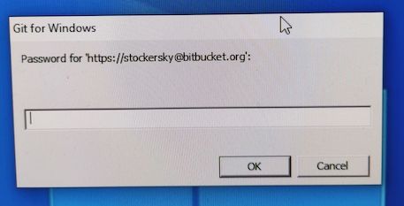

==> then another popup came asking for a passwd : I provided the app-passwd and the repo got cloned :
Actually, I realized this last test with "Windows Terminal" and this last popup was obvious on the screen.
But on my previous tests, I used "VSCode Terminal". The same purpose popup was issued within VSCode, in the command pallette. Sorry, I did not noticed it.

- first popup to input app-password (clearly managed by Bitbucket)
- then routed to Oauth
- if refusing Auth --> another popup (managed by Git itself) ask for app-passwd
-  cloning
