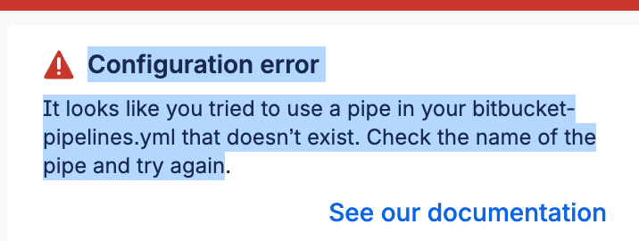

Is it possible to refer a Bitbucket Private repo in Workspace-A in a bitbucket-pipeline.yml in Workspace-B
- pipe: *workspacename*/*repository-name*:v1.0.0
It throws me the below error. But when i change the Repo in Workspace-A to public it works. Any workarounds that can be used here? Apart from Dockerising the repo.
Configuration error
It looks like you tried to use a pipe in your bitbucket-pipelines.yml that doesn’t exist. Check the name of the pipe and try againimage.png

Unfortunately, when using a Pipe, the repository should be public (see this doc for more info).
Apart from the Dockerising the repo, here are some alternatives to interact with another repository:
  • You can simply Git clone the repository and proceed
  • If you'd like to get a YAML configuration available from another repository, you can use shared Pipelines configurations
  • If you'd like to trigger a Pipelines build in another repository, you can use this Pipes script called trigger-pipeline
