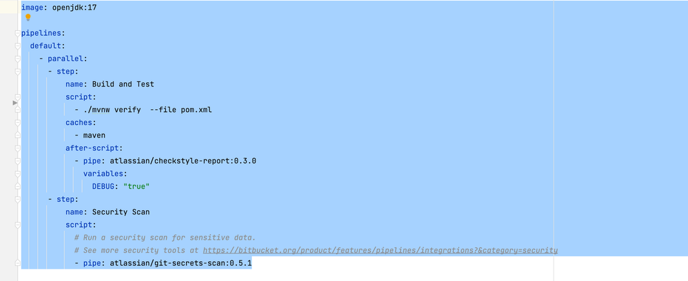

we have a pipeline works before ,but recently it keeps fail due to the timeout issue.

Thanks for replying.  I am actually not sure how large the cache needs to be downloaded or where the cache downloads from. from our pipeline.yml file, it just configured this caches as maven , I am not sure where the cache stores
