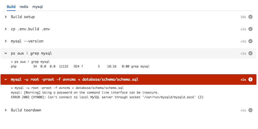

+ mysql -u root -proot -e "CREATE DATABASE avncms"
mysql: [Warning] Using a password on the command line interface can be insecure.ERROR 2002 (HY000): Can't connect to local MySQL server through socket '/var/run/mysqld/mysqld.sock' (2)
It seems that the service is not ready or i can't access the mysql service from the build container.
Can you try using the other mysql user you are creating (test_user) to check that mysql is available, it looks like root access to mysql is not going to work.
I've just noticed in your above screenshot that you are running a version check on mysql, followed by a ps -ef.
It looks like you aren't seeing the mysql process running, so I would guess the version check is failing too.
I just built a quick pipeline test using a similar config file and don't see mysql started either.
