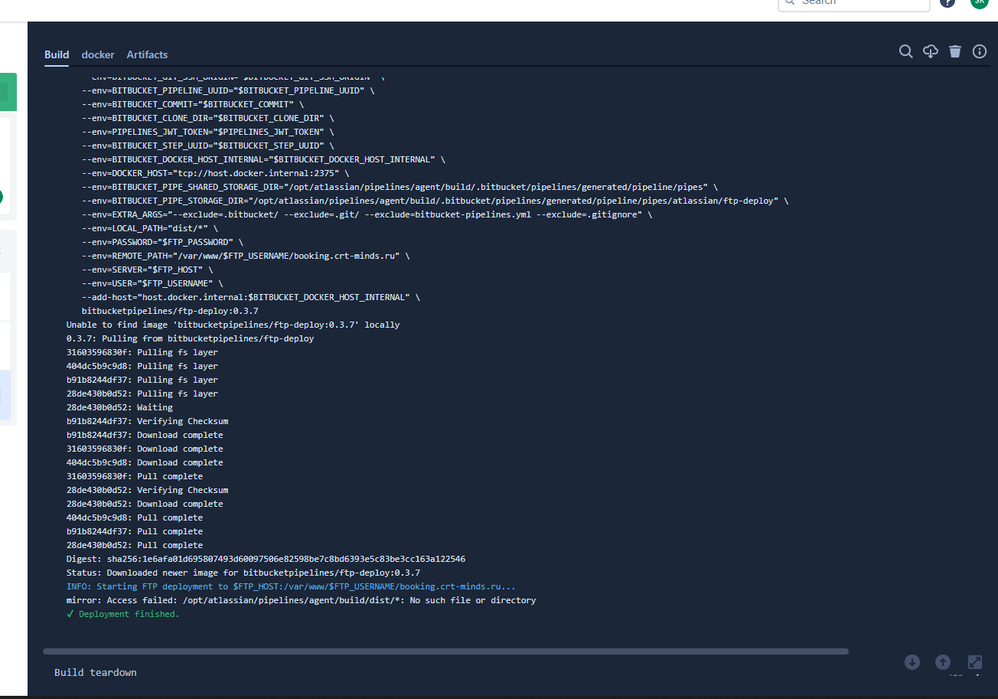

mirror: Access failed: /opt/atlassian/pipelines/agent/build/dist/*: No such file or directory
Said Kamolov
December 22, 2022

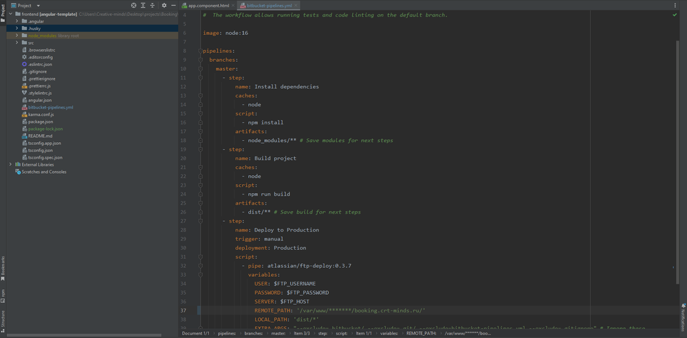

My bitbucket pipelines failed when i try to deploy my dist folder to ftp server. first photo off error and second one is my yml file. can anybody help with this?image.pngimage.png

Hey @Said Kamolov
G'day, and welcome to the community.
Can you edit the local path and remove the asterisk "*" in the path to 'dist/' as an example below:
               - pipe: atlassian/ftp-deploy:0.3.7
                 variables:
                   USER: '$username'
                   PASSWORD: '$password'
                   SERVER: '$ip'
                   REMOTE_PATH: '/var/www/html'
                   LOCAL_PATH: 'dist/'
                   DEBUG: 'true'
Also, enable the debug options to get a more verbose log that will help with your troubleshooting.

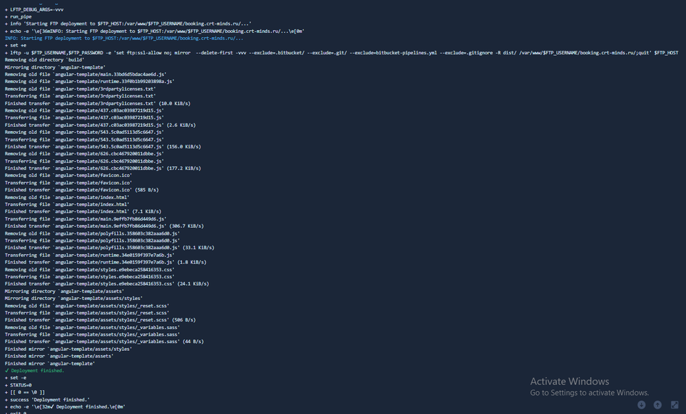

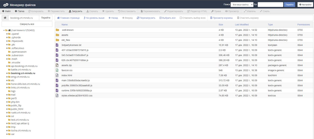

it shows that deployment was successful image.png, but in my server nothing changed image.png
could you please give explanation why this might be happening?

I don't think it's an issue with the pipeline anymore. It looks like the files have been transferred successfully from the screenshot. This could be a cache or something else on your FTP server.
Try clearing the cache on your FTP server, and will see if that helps.
