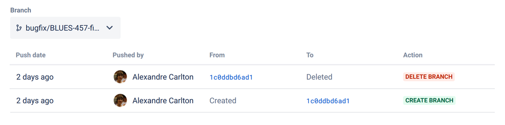

is there a api to get push-log for a particular branch.
Jega
May 25, 2021
I can see there is page where we can see the push-logs in bitbucket.
https://confluence.atlassian.com/bitbucketserver0710/push-logs-1044105624.html?utm_campaign=in-app-help&utm_medium=in-app-help&utm_source=stash
is there any api to pull this log ? . this will be really helpful to find out who and when this branch got created .
