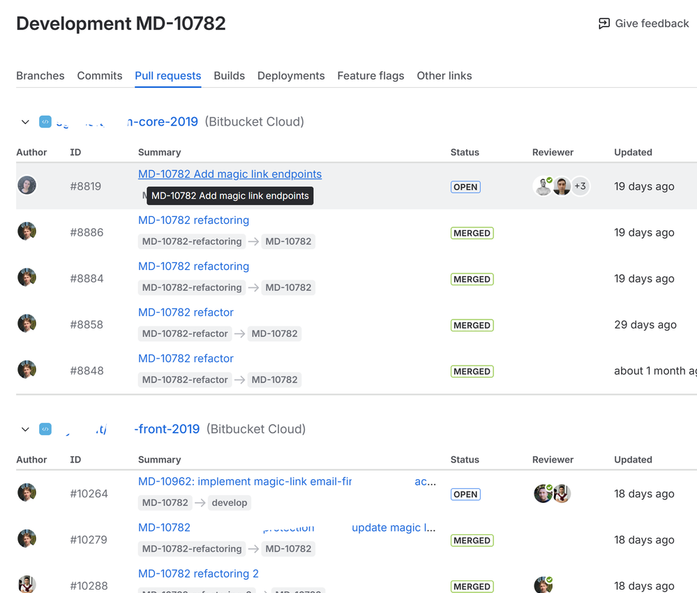

Anton Bimakov
April 4, 2026
e.g. in jira PR is referenced like https://bitbucket.org/%7B8b57baea-ae50-4078-8bfc-d0c0fb51dc09%7D/%7B11451fec-edef-41d5-8ecc-dd53c0b4547d%7D/pull-requests/8911 and other team members can not access it, just me.

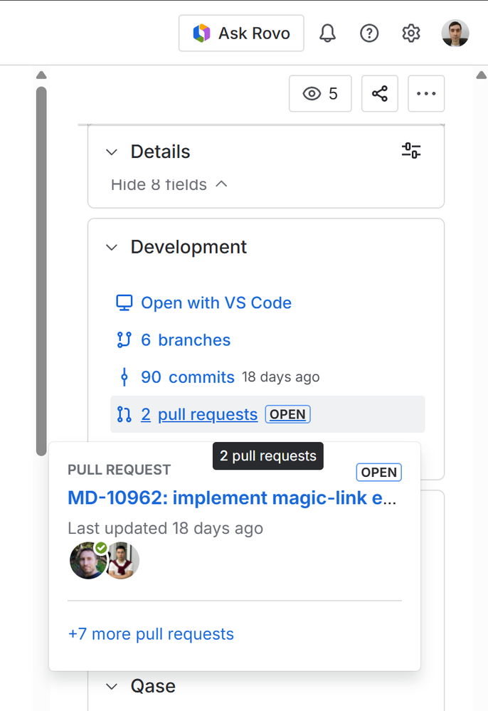

Hi! I'm browsing work item in Jira, on right sidepanel there is "Development" section, which shows PRs, branches and commits of associated Bitbucket repository. Links shown in this section uses kind of personalized urls involving unique ids, it is kept even when I navigate and subnavigate it. So I can't share URL of PR, commit, comment etc if I came to Bitbucket via such link, instead, when I want to, I have to open Bitbucket directly, find the same PR or commit or file in corresponding workspace, then share regular-style URL.

I use direct work item link like https://**.atlassian.net/browse/**-7831 (from e.g. project board) and from-filter links like https://**.atlassian.net/issues?filter=**&jql=**&selectedIssue=**-7831. Does not affect how Bitbucket URLs are formed in Development sidepanel section, it is always sanitized/personalized, not direct links to PRs.
It is some recent weeks or months change, previously I saw direct links here.
