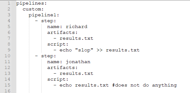

I want to get the output value from one step to use as an input on a subsequent step.
I am able to successfully get data/values into an artifact.  I tested that by running the build, then manually downloading the artifact, and seeing my data was indeed in the artifact.
I cannot find anywhere which shows how the syntax for reading the contents of an artifact and using the contents in a subsequent step.
step "richard" works fine.  step "jonathan" doesn't work- note that I'm only using echo in step "jonathan" to see if i've been able to read the contents of  results.txt.
I've searched the forums for hours.  I see over and over mentions of using an artifact in subsequent steps, but can find no syntax/demo of code that actually does that.

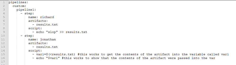

Finally figured out how to do what I needed:
