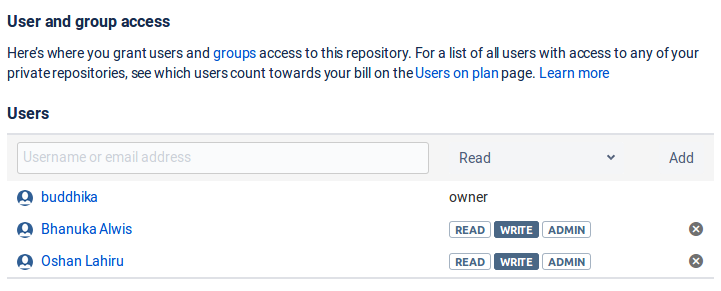

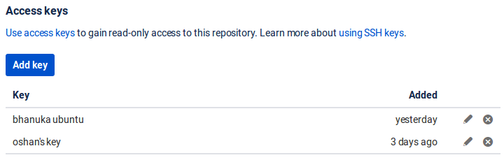

curently in one of my repository has three people within it. problem is admin is the only person who can has write access for the repository. for other two users only have read access. but when they see the permission status for the repository , it show as write . when they pushing commits to the repository , they can see access key only has read permission error.
following permission were defined in repository by me. please help me to figure out this problem.

Hello @buddhika,
What is the repository URL users are pushing against? Perhaps they are pushing over SSH where the SSH key added in Bitbucket server was with Read-only access.

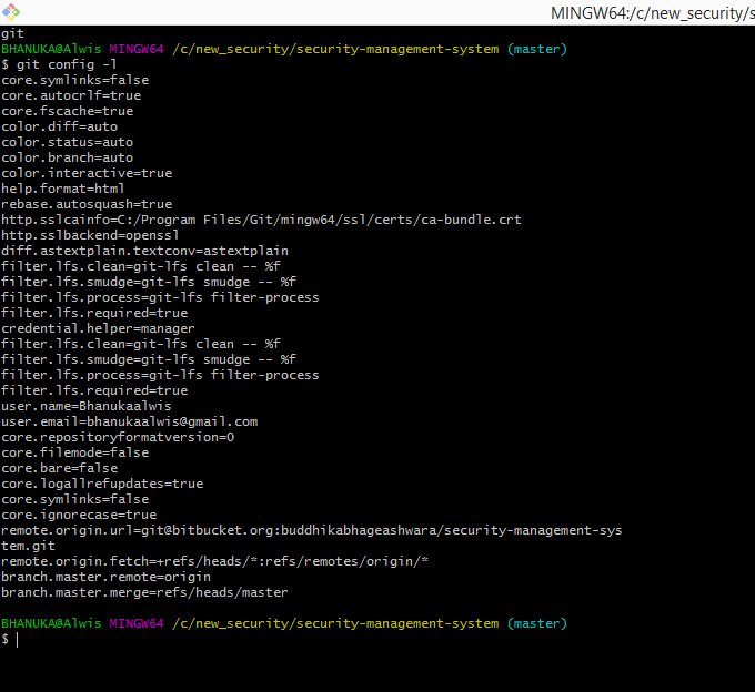

In the screenshot you have provided, please ask the user go to /d/project.security-management-system (master) in mingw-w64 or Git Bash and run:
git config -l
And check what is described in remote.origin.url

HI @rsperafico,
following configurations were found once execute the git config -l command. but couldn't able to found a issue here. please help me to figure our this issue.

rsperafico
December 27, 2017
Hello @buddhika,
Thank you for your update.
Based on screenshot provide we can notice your repository is hosted on https://bitbucket.org and not on Bitbucket server.

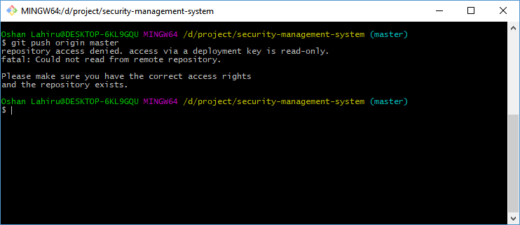

buddhika
December 22, 2017
buddhika
December 22, 2017
Hi @somethingblue,
thanks for the quick response, that is not the error what have you mentioned in here. please find the above mentioned error for the write access when oshan and bhanuka try to write on the repository .
please find the text format of the error message from follwoing  which getting the users:-
$ git push origin masterrepository access denied. access via a deployment key is read-only.fatal: Could not read from remote repository.
Please make sure you have the correct access rightsand the repository exists.
