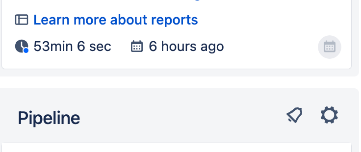

But in this case it's scheduled:
Where can i get the UUID of the Scheduled user?
