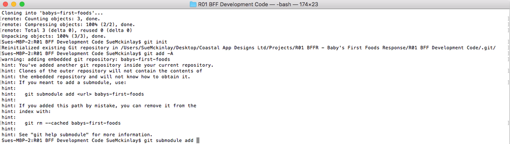

I am using Terminal instead of Sourcetree for git and bitbucket use.
My project is iOS app development and when you set up a new app within Xcode with Testing and Core Data, the system sets up files and folders.  So if i want to have the development code within the version control it should have the folders and the files within that.
If it helps, you can see that I have set up and cloned the repository, with 3 items within taken from the screen shot below.  However, I got a message saying that i was adding a repository within a repository (i take it folders are seen as a separate repos) and it's asking me to add a submodule.....  Done a search within bitbucket but cant seem to find anything appropriate. I just want one version control on all files, including 'submodules' and their contents.
Any help very much appreciated,

Hi Sue! If you're getting the message that you're adding a repository within a repository, it means the folders inside the main one have also been initialized as a repo at some point. Check inside them for a .git folder (it might be hidden depending on the OS you're using).
A git repository within other git repository is what git calls 'submodules'. You can read more about it at Git Submodules. For a tutorial on how to add them, you can check Bitbucket and Git submodules.
