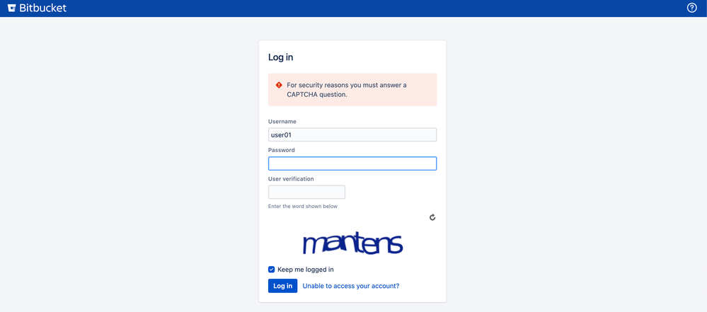

This is likely because you are using SSO to log into Bitbucket through the UI, in which case the CAPTCHA clear page will not be displayed. If you attempt to log in using your username and password in the Bitbucket UI, and the account is locked due to failed attempts, you should see the page to clear CAPTCHA.

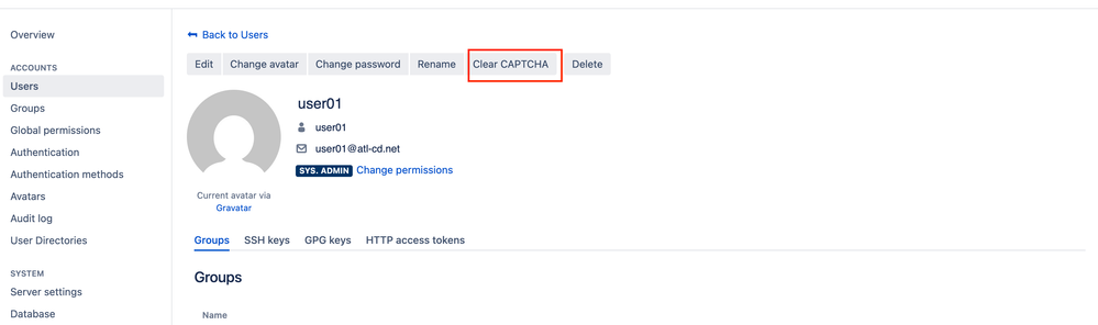

If SSO is the only authentication method available through the UI, you can request a Bitbucket sysadmin to clear the CAPTCHA from your user profile. If you are a sysadmin, you can clear your own CAPTCHA. To do this, navigate to Settings > Users, search for the affected username, and click on the "clear CAPTCHA" button.
