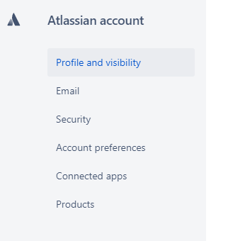

Hello, following the tutorial here, I can't find what I need:
https://confluence.atlassian.com/bitbucketserver/personal-access-tokens-939515499.html
  1. Go to Profile picture > Manage account > HTTP access tokens.
  2. Select Create token.
Here is what I have:

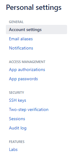

Nothing also in personal settings:
Did it move somewhere else ?
In my atlassian settings, nothing here also.
I want to create an access token to clone, trough https, one of my repo's.
Thanks !
seanaty
November 24, 2021
The link you reference is for Bitbucket Server but the screenshot you shared is from Bitbucket Cloud.
To clone through HTTPS Bitbucket Cloud recommends what's called an "app password" (because it can also be used to make requests to the Bitbucket API).
You can see the link to "App passwords" in your screenshot. Create one there.
