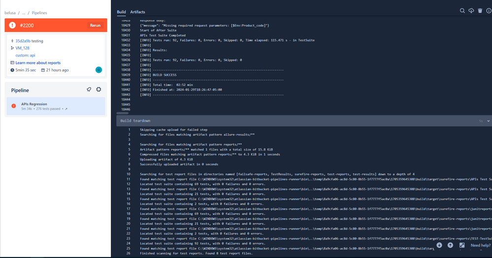

I have a pipeline with which I am trying to run the automated tests of my API suite, using the runner to run self-hosted on Windows and be able to establish a local connection with the services and databases
When I run my tests locally they all pass and the execution is successful, but in the pipeline, the execution is failing despite not having tests with errors.
The tests I am running are using maven, java, rest assured, testng.
This is the part of the pipeline that is being executed
Where P refers to the profile in maven and -Denv is an environment variable that refers to the environment

This is part of the runner's logs
Test report processing complete.
Updating step progress to COMPLETING_LOGS.
Appending log line to main log.
Shutting down log uploader.
Tearing down directories.
Cancelling timeout
Completing step with result Result{status=FAILED, error=None}.
Setting runner state to not executing step.
Waiting for next step.
Finished executing step.

The runner was configured again from 0 and I still have the same problem, the tests run without problem, and even without error the pipeline is failing, and in the runner console you can see "Completing step with result Result{status=FAILED, error=None}"
