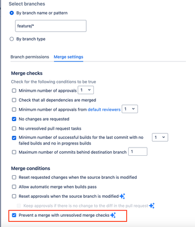

This happens because, by default, the merge checks are just a suggestion for the developer, meaning that the developer can still merge the changes even though not all the merge checks were met (see Suggest or require checks before a merge)
The ability to enforce that each and every merge check is satisfied before a developer has access to merge is part of the Premium plan, where you would need to enable the option "Prevent a merge with unresolved merge checks" in the branch restriction :
This would enforce that all the merge checks configured in that branch restrictions will be mandatory before the users are able to complete the merge. Even though they see the merge button, with that option enabled, they wouldn't be able to complete the merge and a warning message will be shown.
