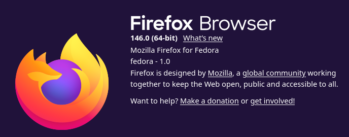

I am also encountering this issue.
Firefox on Linux (Fedora-based). Similar to others, I was able to get Bitbucket to load using a Chromium browser.
