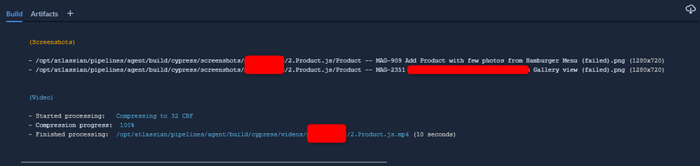

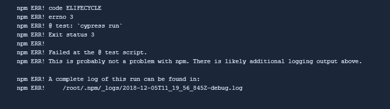

piotrpodyma
December 5, 2018
I tried as you wrote. When every pipeline (tests) failed then I always got this message:

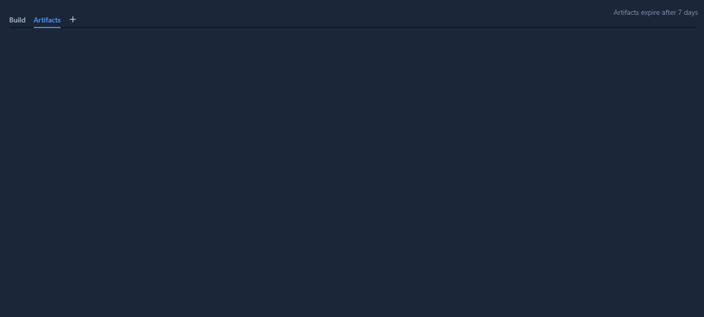

What I'd like to do is to see screenshots when something went wrong.
Artifacts tab is still blank

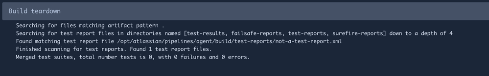

If that doesn't work. Can you take a screenshot of the 'Build Teardown' section, as there is a 1GB file size limit for artifacts, and you may be hitting it.
e.g.
piotrpodyma
December 17, 2018

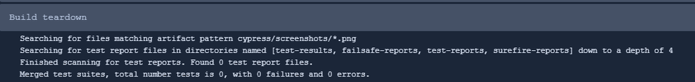

I tried change artifact's path to many different options, but nothing helps. Here is an example of 'Build teardown':
I also tried to add:
- set +e npm run test
to
bitbucket-pipelines.yml
to pass pipeline, but nothing happened, and every time I get the result as shown above
