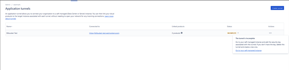

The bitbucket instance is connecting to Atlassian cloud, but we are getting an Incomplete Status from Atlassian Cloud for the Application Tunnel.
This is the screenshot from Atlassian:

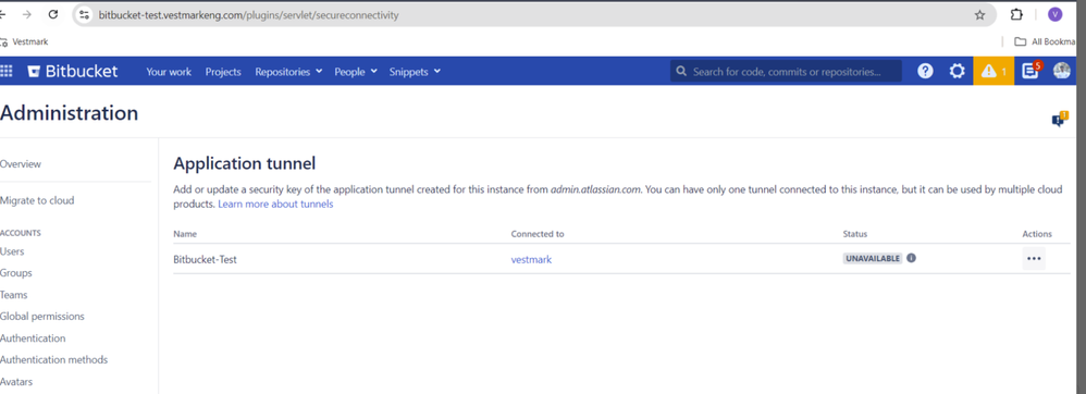

Sometime whenever we insert the key it says status as unavailable but otherwise it shows as Connected. This si the screenshot from bitbuckettest server:

You might have one more step to go...
Incomplete:
The tunnel has been created in admin.atlassian.com, but its security key hasn’t beed added to your self-managed instance.
To solve this issue:
Edit the tunnel in admin.atlassian.com, and copy the security key.
Add the key to your self-managed instance.
ref: https://support.atlassian.com/organization-administration/docs/troubleshoot-application-tunnels/
