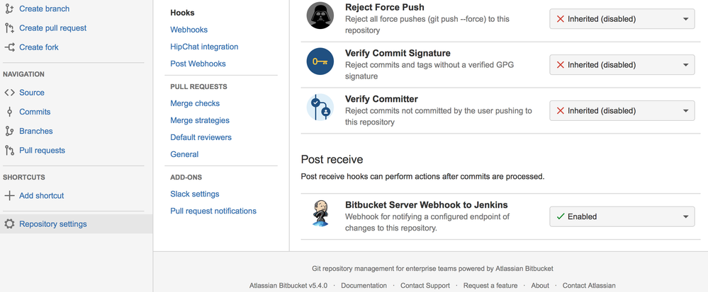

So I am making use of bitbucket server and the hook configured in bitbucket seem to work properly. Maybe it is the same for bitbucket cloud as well, its almost the same answer but please revisit the config just to be sure

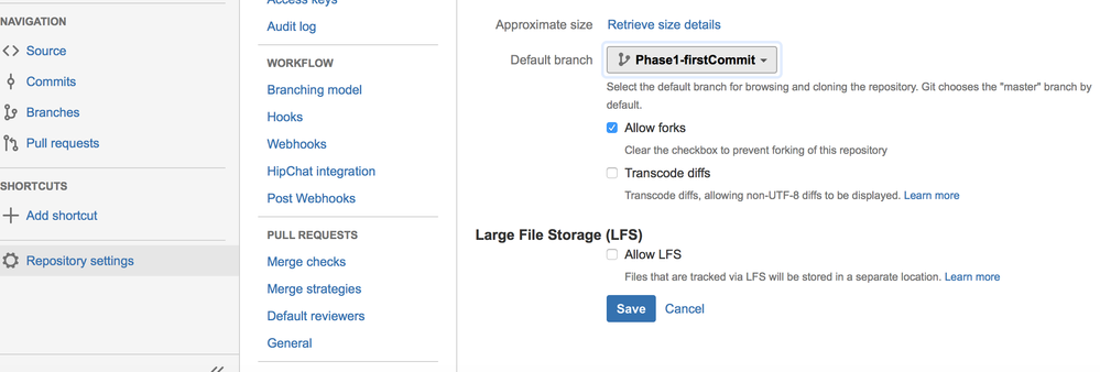

I also modified the default branch in the repository settings of bitbuckeScreen Shot 2018-11-07 at 5.52.43 PM.png

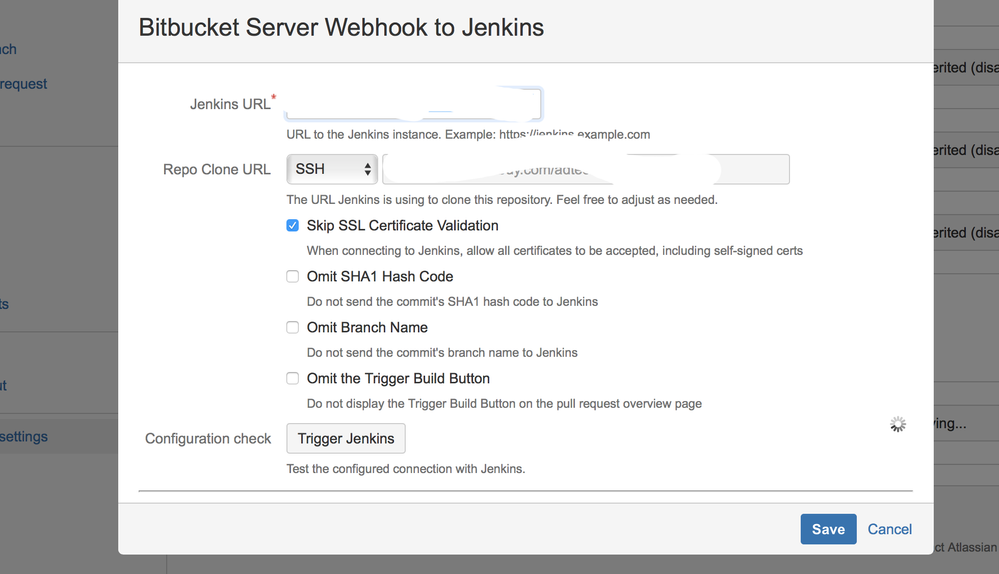

I configured the hooks to insert the jenkins url using the webhook plugin provided by atlassian
These are the settings

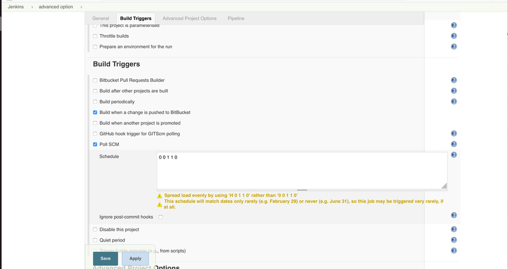

I installed the following plugins in jenkins
Bitbucket branch source
Now I enabled the build triggers in my pipeline project (advanced option is the name of the pipeline)
Hope it helps!!

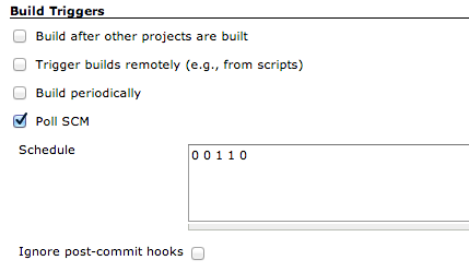

Here is the key - please read docs carefuly :)
3. Enable the Poll SCM option in the Build Triggers. This is required to remotely trigger a build. Since we don’t really need to poll, you can set the poll frequency to poll very infrequently.
4. Save your project configuration.
