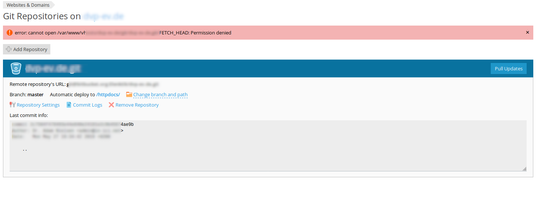

Go to your repository, click on "Pull Updates" and a error might appear there.

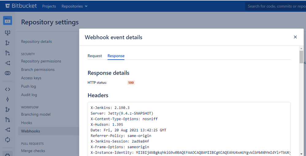

Getting 500 error while creating webhook on bitbucket inpremise-server
Please help me resolving below issue

Well, I did not found a more specific error information in the log. But when I tried to manually click on "Pull updates" a permission denied error appeard and I could  fix it by changing user permission. See https://webmasters.stackexchange.com/a/123124/34589
