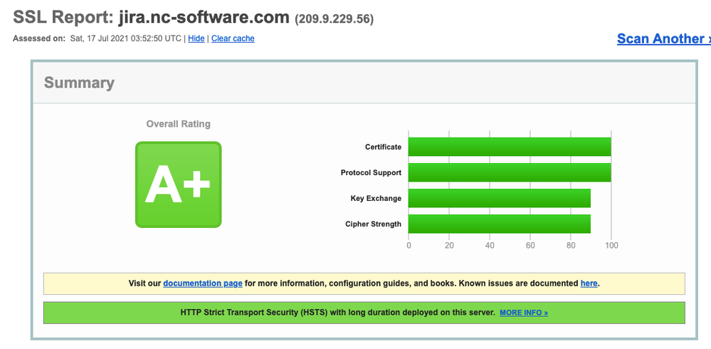

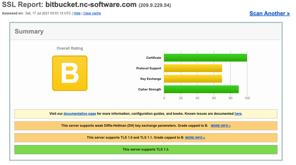

Hi @Neal Culiner
the ssl config of your bitbucket and jira instance differs.
Assuming that you have an LB/reverse proxy in front of the instances where ssl gets terminated i would see if the config differs.
If you are accessing bb or jira directly then you need to review the ssl settings there.

Thank you for the reply and info. Both are on the same server. It looks like I need to review the bitbucket config to only allow the higher TLS and see if that helps.

I made a few revisions for the TLS 1.0 and 1.1 as I found the property I needed for that. I turned off public access to the Bitbucket 7999 port for SSH as I only need that for internal use behind the firewall. So far so good, will continue to monitor.
