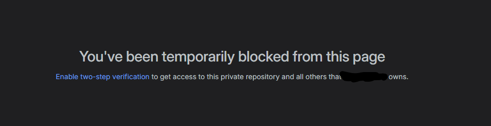

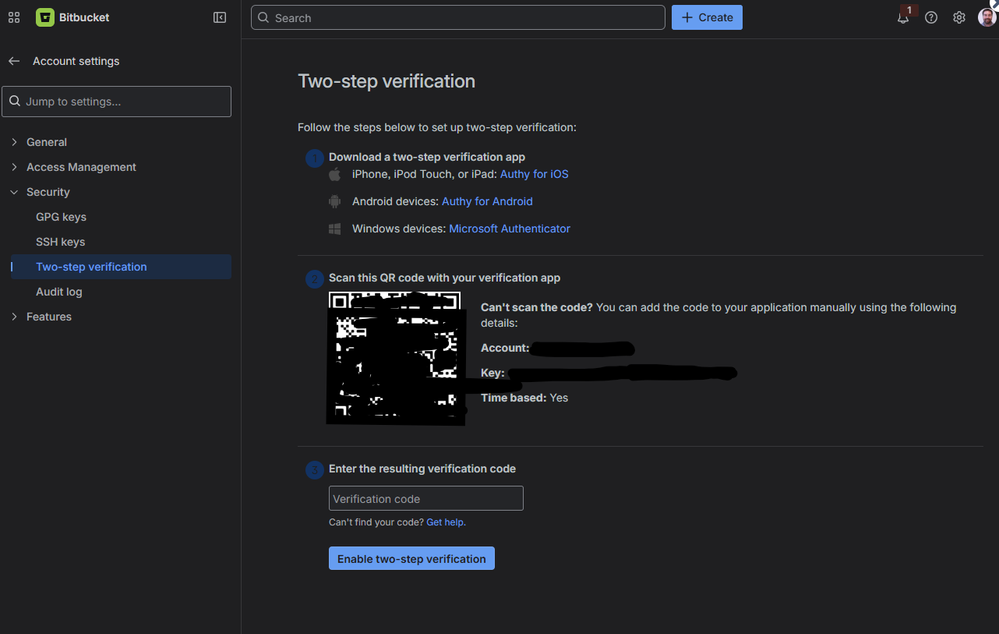

 - I believe it's Atlassian account 2FA being asked for. Screenshot below.
 - I've tried Authy once, and Authenticator... both on iPhone. Yes time is auto synced also.
 - Yes, tried the newly generated code as well.
Thanks for the advice, I'll check in with the org admin on my account details.
Here is the screenshots of the 2FA requirement.
Thanks

The two-step verification page appears to me to be an Atlassian 2FA page.

@Sean Holmesby
1) OK so this is Bitbucket Cloud 2FA, which is separate from Atlassian Cloud organisation setup / Guard. Probably a legacy Bitbucket instance and/or hasn't been integrated with Atlassian Cloud organisation properly.
2) If the code is not being accepted back in that very page – that's a problem worthy raising with Atlassian. No need to talk about your IdP, your 2FA, etc. — this is just a problem with Bitbucket 2FA
3) You may want to delete the images you've posted or at least redact them — as they show your email address AND the TOTP key
Like # people like this
Sean Holmesby
July 8, 2026
@Ed Letifov _TechTime - New Zealand_ Thanks. I've updated the images. I will chase this up with Atlassian.
