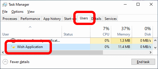

I'm trying to update Git on Windows and get the warning
Upgrade Git on Windows - Wish Application (PID 6388, closing is required)
but have no idea how to close it. It's not listed in Task Manager.
CarlBateman
July 26, 2020
I found the Wish Application under the Users tab in Task Manager and ended it there.

Hi @CarlBateman,
Two options for finding out what that is (when using either option I recommend opening it as administrator to ensure you have access to view system processes as well)
1) Open a command Prompt and type 'tasklist' this "should" display a list of all running processes and their associated PIDs
2) Open a PowerShell window and run "Get-Process" this should so the same thing but for me appears to be more verbose.  You can also pass the -Id parameter to search for a specific process by ID  (i.e. 'Get-Process -Id 6388')which might be helpful in your particular situation.
I hope that helps you figure out what process is blocking the upgrade.

Thanks for the suggestions. I was able to fix it in the end (see elsewhere), but was too busy to post the fix.
