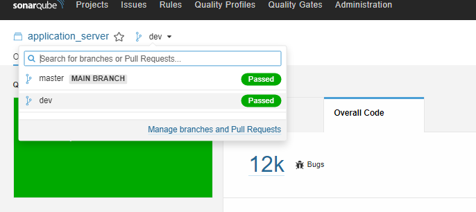

Installed sonarqube version 9.0 developer edition. I am able to scan multiple branches(master and dev) and able to see the report in Sonarqube UI for both branches.

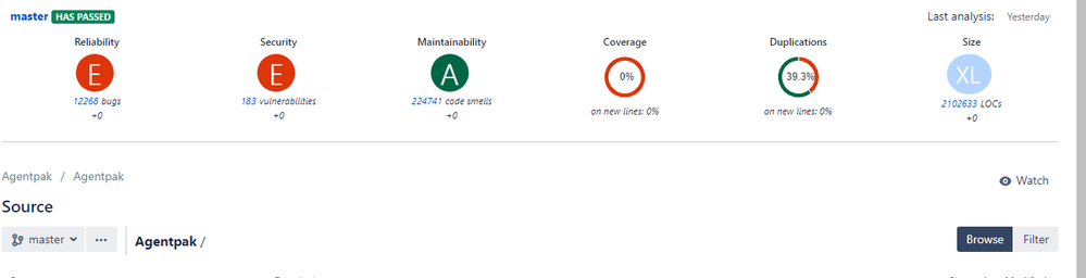

But in Bitbucket UI i am able to see report only for master branch.

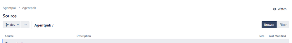

Whenever I tried to scan for the pullrequest from dev to other branch getting below error
No Sonar data found for project "AG_agentpak-com.nd:application_server:dev". Please wait for the build to be finished or check your build configuration and reload this page afterwards.
