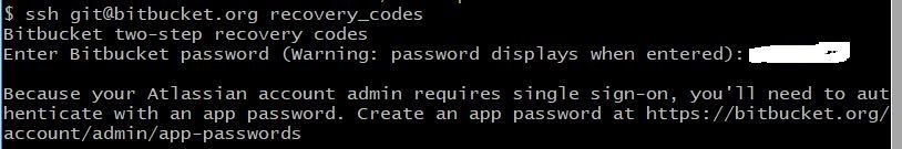

December 7, 2018
Same issue here:, While recovering the codes IT keeps on saying:
Because your Atlassian account admin requires single sign-on, you'll need to authenticate with an app password. Create an app password at https://bitbucket.org/account/admin/app-passwords
The problem is that to generate an app password I need to access my bitbucket account; however, I cannot access my account. Therefore, what do I do at this point?
Have created a ticket as well BBS-94918 Urgent | Account not accessibleCapture.JPG

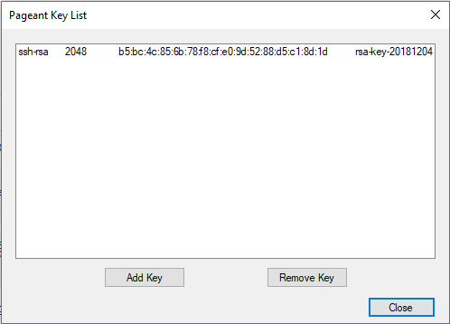

cristelledoong
January 15, 2019
Hi @John Cotter and @Ana Retamal, this is the response:
$ ssh-add -l
The agent has no identities.
$ ssh-add ~/.ssh/SSHKEY_PVT.ppk
Error loading key "/c/Users/admin/.ssh/SSHKEY_PVT.ppk": invalid format
 The key is loaded to Pageant as well
cristelledoong
January 15, 2019
Nevermind, guys. I already fixed it.
> From SourceTree I loaded my SSHKEY_PVT.ppk, then on Conversion menu, I clicked the Export to Openssh file format. It will create a new file format. I named it id_rsa_pvt.
> I entered this command:
$ ssh-add ~/.ssh/id_rsa_pvt
Enter passphrase for /c/Users/admin/.ssh/id_rsa_pvt:
Identity added: /c/Users/admin/.ssh/id_rsa_pvt (/c/Users/admin/.ssh/id_rsa_pvt)
> then entered this command after:
ssh git@bitbucket.org recovery_codes
> I got my recovery codes now!
