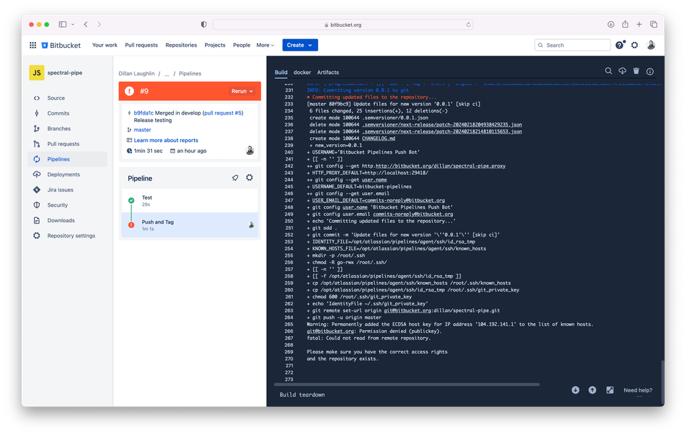

I'm working on creating my first Bitbucket Pipe (https://bitbucket.org/dillan/spectral-pipe) and following the steps described in the documentation. When attempting to release I go to merge into `master` when trying to Push and Tag the release.
It successfully goes to Docker Hub, but changes (e.g. CHANGELOG.md, pipe.yml) are not being committed back to the repository, failing with the following pipeline error.

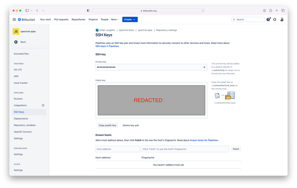

Configure repository ssh key pair and it will be safely used in pipeline to push to current repository.
I've done so in Repository Settings > Pipelines > SSH Keys as shown below:
I double checked, and I do have a `master` branch created. How can I address this issue so that the changes are committed back to the repo and the pipeline can complete successfully?

If you have generated an SSH key pair, then you need to add the public SSH key to your account's SSH keys here: https://bitbucket.org/account/settings/ssh-keys/
Alternatively, you can also delete the SSH key pair from the Repository settings, and then the http proxy and http origin will be used to push (no configuration is needed from your side).
Please feel free to let me know how it goes.
