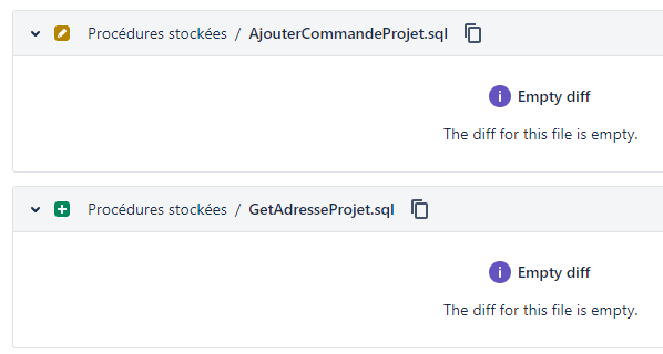

Since this morning, I've been unable to see the differences in the files when I view a pull request or a commit. It indicates to me "The diff for this file is empty."
The "Whitespace changes" parameter is checked, and I've disabled all extensions installed on Chrome.
The files indeed contain modifications.

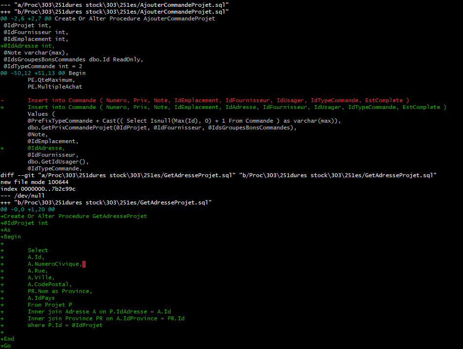

Could you please confirm if when running the diff locally using the following command you get any output for those files?
git diff PR_destination_branch...PR_source_branch
This is the diff that is calculated in the UI when opening a pull request, so I'm interested to see if those files are listed with any change if executing the same command locally.
Thank you, @William Lemieux !
Patrik S
William Lemieux
February 20, 2024
I confirm that the git diff command returns me all the diffs as bitbucket is supposed to.

I noticed, in my case, that the problem seems to be present when the files names contains spaces OR files are present in a folder that contains spaces in the name
