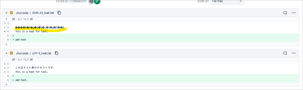

And I couldn't reproduce this issue on follwong URL, because this issue happen in text.
https://bitbucket.org/teamfortesting/test-repo/pull-requests/1
Attahced picture (sample_pullrequest.png) is a sampel PllRequest for understanding this issue.
- Shift-JIS_text.txt
- line 3: Yellow line is a text by using Shift-JIS (text garbled happen)
- UTF-8_text.txt
- line 2: This text is created by UTF-8 and we can read it.
Do you have any ideas/ways on how to solve this issue.
Best Regards,

Hi, @Jun Takaba
I'm afraid this is a known issue on Bitbucket Cloud. Currently, Bitbucket Cloud supports only the UTF-8 format. As a result, it will treat files with other encoding formats as a UTF-8 format, that's why you're seeing the garbled or byte text in your encoded file.
