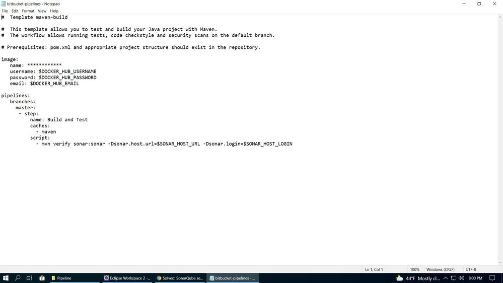

Sandeep.Dash
March 16, 2022
Hi, Theodora,
This is a dedicated sonar-cube server hosted on one of the datacenter. We can only access it through a URL within our company network using a username and password.
This cannot be accessed outside of company network.
I tried to update my bitbucket-pipelines.yml file so that when i push the code from local repo to remote, the pipeline would be triggered, automation code would run and then quality gate result would be displayed in sonarcube. I followed the steps as per the below screenshot but getting the above error: URL couldn't be reached. Attaching the pipeline yml file and screenshot of the page on sonarcube where it asks to follow some steps to configure. I would appreciate your help on this.
Theodora Boudale
March 18, 2022
Hi @Sandeep.Dash,
If the server cannot be reached outside of your company's network, then Pipelines will not be able to reach it either.
I suggest talking with your network administrator and asking them if it's possible to make the server accessible from the IPs that Bitbucket Pipelines are using. The IPs are the ones I listed before:
You don't have to make the server accessible from everywhere on the internet, but it needs to be accessible from the IPs listed above. Otherwise, Pipelines won't be able to reach it.
Kind regards,
Theodora
Sandeep.Dash
March 24, 2022
Thanks @Theodora Boudale  for your quick response. Appreciate it. I will whitelist these ip address and also have to make few changes from sonarcube server side as an admin to get it configured with cloud bitbcuket.
