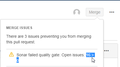

I have a PR created in our BitBucket Server but the Merge is being prevented as shown in the attached screenshot (Open issues: 16 > 0).  I'm trying to figure out where this is configured.

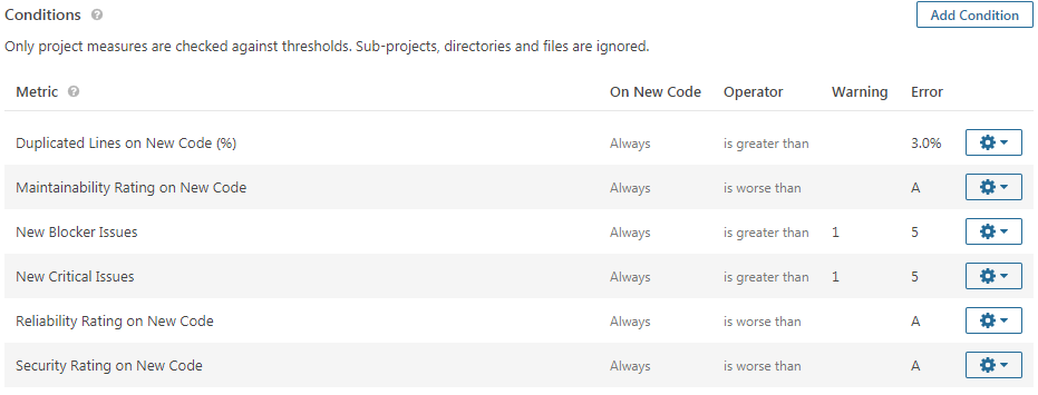

I've attached a screenshot of the Quality Gate we are using for the project and do not see that metric there.  How do we change this?

This pull request merge block message comes from a failed quality gate in Sonar. Could you please double-check that you are looking at the quality gates of the project you analyze (and not at the quality gate of a different project) and if you can find a quality gate with a metric called "Open issues"?

I confirmed that the Quality Gate conditions in the screenshot I gave was the one configured to the project.  There are only 2 other quality gates configured (Sonar way + another custom one) and none of the 3 gates have the "Open issues" condition.
I even tried to add the "Open issues" condition to the gate and re-running a sonar scan but is still preventing merge with message: "Sonar failed quality gate: Open issues: XX > 0"
In the repository settings for the Sonar plugin, under the Merge Checks tab, I have "Merge Checks" enabled as well as "Use SonarQube Quality Gates"
