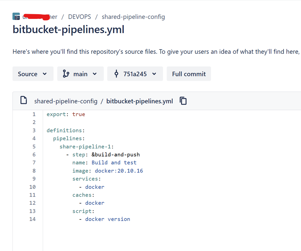

Indra Rizky
June 30, 2025
hi all.
based on bitbucket team, this config work on me.
repository shared-pipeline-config > bitbucket-pipeline.yml
export: true
definitions:
pipelines:
share-pipeline-1:
- step: &build-and-push
name: Build and test
image: docker:20.10.16
services:
- docker
caches:
- docker
script:
- docker version

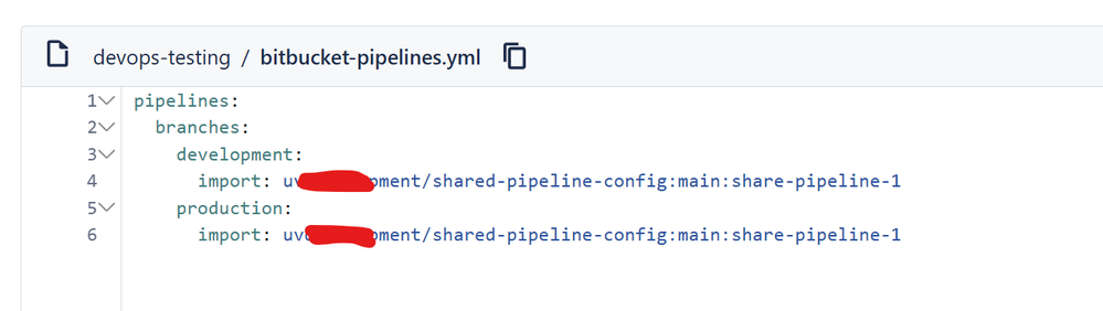

repository backend-service > bitbucket-pipeline.yml
pipelines:
branches:
development:
import: shared-pipeline-config:main:share-pipeline-1
production:

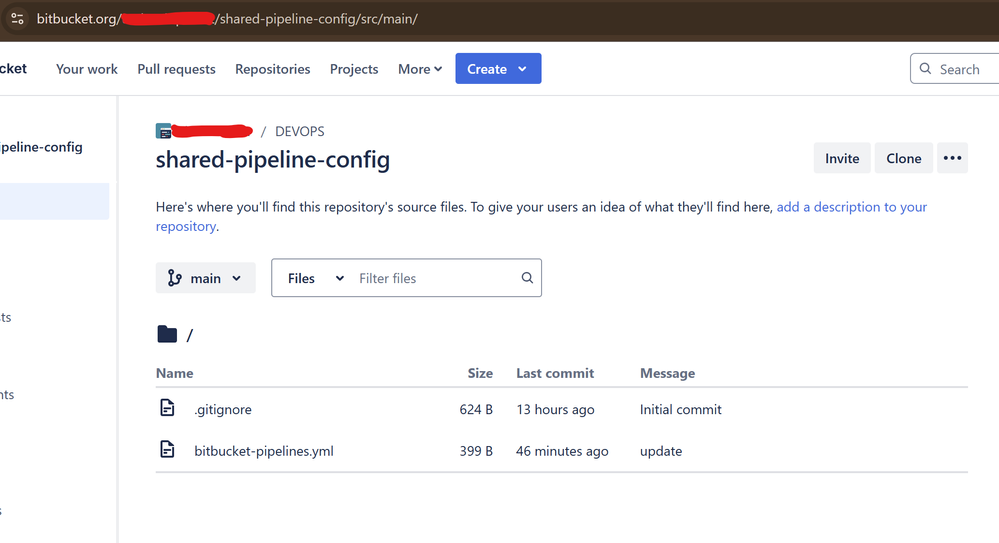

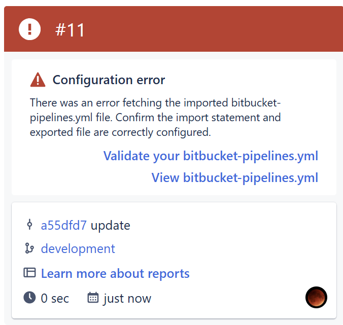

Indra Rizky
June 26, 2025
hi @Ben , thanks for the answer
i already tried it, now pipeline was triggered but somehow the pipeline shows error

Ben
June 26, 2025
Hi @Indra Rizky
To investigate this further - we need access to your workspace, including your YAML configuration and build environment/build logs.
