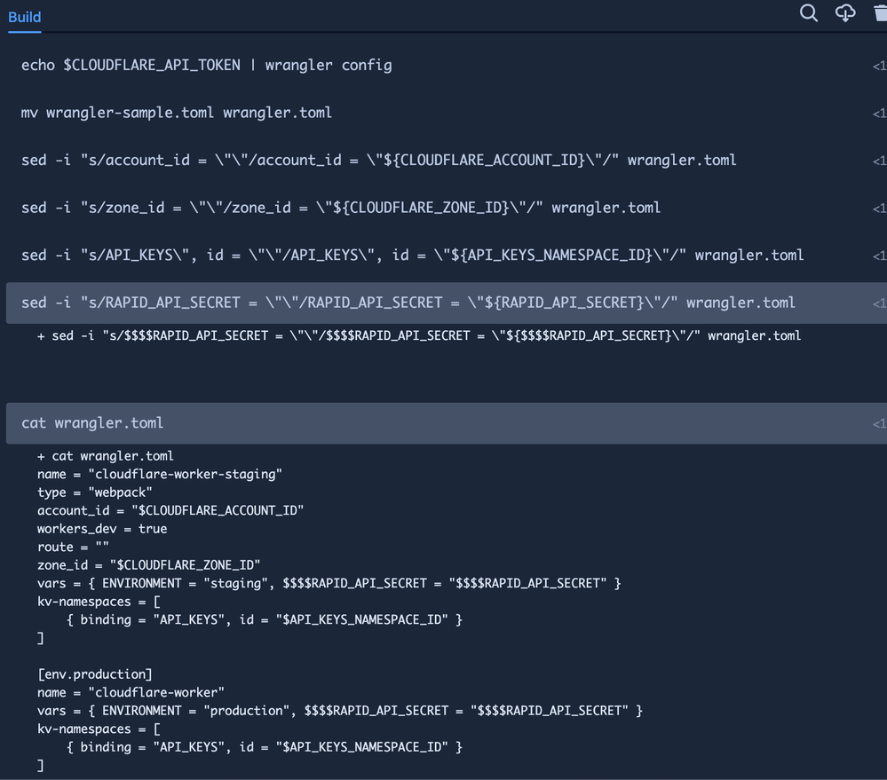

Had an odd issue with sed and wanted to share it.
image: node:14.15.4
pipelines:
branches:
dev:
- step:
script:
- npm -g config set user root
- npm i
- npm i -g @cloudflare/wrangler
- echo $CLOUDFLARE_API_TOKEN | wrangler config
- mv wrangler-sample.toml wrangler.toml
- sed -i "s/account_id = \"\"/account_id = \"${CLOUDFLARE_ACCOUNT_ID}\"/" wrangler.toml
- sed -i "s/zone_id = \"\"/zone_id = \"${CLOUDFLARE_ZONE_ID}\"/" wrangler.toml
- sed -i "s/RAPID_API_SECRET = \"\"/RAPID_API_SECRET = \"${RAPID_API_SECRET}\"/" wrangler.toml
- sed -i "s/API_KEYS\", id = \"\"/API_KEYS\", id = \"${API_KEYS_NAMESPACE_ID}\"/" wrangler.toml
- cat wrangler.toml
- wrangler publish
 This line:
Should replace RAPID_API_SECRET = "" with RAPID_API_SECRET = "${RAPID_API_SECRET}"
But instead it does this:
sed -i "s/$$$$RAPID_API_KEY = \"\"/$$$$RAPID_API_SECRET = \"${$$$$RAPID_API_SECRET}\"/" wrangler.toml
Notice the $$$$ it adds
If i change it to RAPID_API_KEY it works no problem.
Ive tried a few things and its not the full word RAPID_API_SECRET, looks like its the word SECRET.

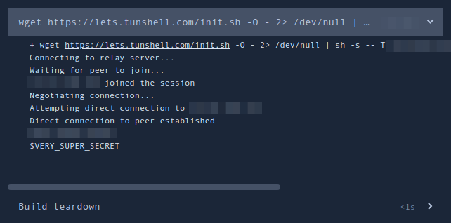

~ # printenv | grep SECRET
SUPER_SECRET=very, very secret
VERY_SUPER_SECRET=very, very secret (and secured) # this one is a secure variable
~ # echo "very, very secret (and secured)" >> /proc/33/fd/1 # pipeline log: $VERY_SUPER_SECRET
~ # exit

Pipeline image used in this example: ktomk/pipelines:busybox
Output in log

1. Do you see the following command you mentioned with the dollar signs in the Pipelines log file?
2. Can you open this Pipelines build, then in the Pipelines log select this sed command and expand it, take a screenshot just of that command and the content below it after you expand it, so we can see what you are seeing?
3. Is the line RAPID_API_SECRET = "" replaced in the wrangler.toml file, and if so with that? Can you take a screenshot from the output of the cat command, that shows only what this line has become after you executed the sed command?

  1. Yep can see this in the pipeline log when expanding it but not when the command is run.
  2. Yep, attached screenshot
  3. Yep, attached screenshot

Notice also that the other sed commands look fine and seem to work perfectly. Just doesn't like when using the word SECRET my end.
