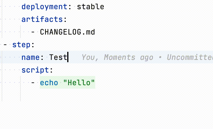

Daniil Penkin
May 25, 2023
Hey @Chris Heale,
Thanks for reaching out.
complex_artifacts doesn't actually require both download and path since there's no required directive. It should work fine with one or both properties (and also with no properties at all, which in fact is invalid in Pipelines, but schema isn't 100% accurate).
Check out the screencast: the step is highlighted when it doesn't match the schema (highlighting isn't very accurate, but that's a limitation of the validation engine used).
Let me know which validation mechanism you use if it doesn't work for you.
Cheers,
Daniil
