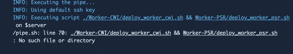

Revan Hernandy
April 5, 2022
Hi Ben,
It's not working when I put more than one shell file to execute.
The scripts become No Such files or directory please find my screenshot.SSH1.png
Ben
April 5, 2022
Hey Revan,
Are you able to ensure the path is correct? I'm noticing that there is no "./" on the other bash script listing. Can you maybe try to create a bash script in the same folder as deploy_worker_cwi.sh which echos a message and attempt to run it?
Ie ./Worker-CWI/testscript.sh && ./Worker-CWI/deploy_worker_cwi.sh
By doing so, you can test if it's an issue with the path or with the command/syntax.
