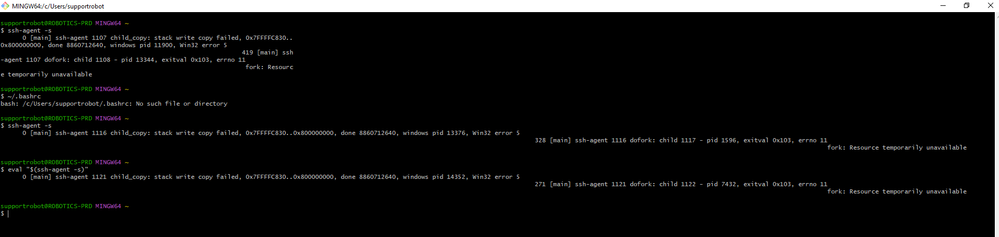

Hi Patrik, thank you for your response. I've installed GIT and when running through GIT Bash, I am not able to start the SSH service. Do you have any advice re that?

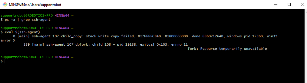

Hi Theodora, thank you for your prompt reply. I ran this and it took me to the next line, so I am not sure if the agent is running ?Then after I tried to start the agent as described on Set up SSH key for Windows. I get the following error. Would you please be able to advise?

Hello @Cornelius ,
It seems like there's some issue with the installation of SSH. I would suggest uninstalling git for windows from your machine, and trying downloading and installing it again from https://git-scm.com/download/win .
Once the new installation is completed, you can try starting the SSH agent again. If the issue persists, could you try the same in a different machine and let us know if you get the same error?

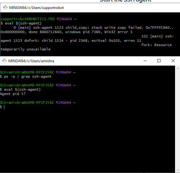

Hi Patrik, I tried reinstalling, and it had the same issue. However, on a different machine I was able to, do you know of why it is not generating one on the desired machine?

Hello @Cornelius ,
As this is particular to one machine only, it seems to be an issue with either the OS or the installation of SSH.
I would suggest trying the following command to compare the SSH version in each of the machines and check if the version are different :
ssh -V
Also, the ssh-agent is a tool used to facilitate the authentication when your ssh key contains a password, so you don't have to type the password every time. However, the ssh-agent is not required to connect to Bitbucket.
In this case, as an alternative to the ssh-agent, you could try creating  a file called config in the directory ~/.ssh/ with the following content :
 Host bitbucket.org
     HostName bitbucket.org
     User git
     IdentityFile ~/.ssh/<name of your private key>
     IdentitiesOnly yes
where in IdentityFile line you should provide the path to the private key, of which the corresponding public key you have already added to your Bitbucket account.
This config file will instruct SSH to use that key for any SSH connection to bitbucket.org domain. You can then use the command below to test cloning a repository you have access to :
GIT_TRACE_PACKET=1 GIT_TRACE=1 GIT_SSH_COMMAND="ssh -vvv" git clone git@bitbucket.org:<workspace>/<repository>.git

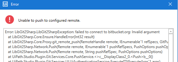

Hi Patrik, the versions were same. I managed to generate an SSH key through installing source tree and added it under Personal Key in Bitbucket. After I tried to push it to the repo by cloning the ssh url after git clone but I am getting an error saying failing to connect to bitbucket.org :(bit.PNG

Hello @Cornelius ,
From the screenshot you have shared, it seems you are using a different tool to interact with Bitbucket, which seems to be UIPath. Unfortunately, I have limited knowledge of the UIPath configuration.
Did you have a chance to test creating the config file, and using the clone command with verbose logs I shared in my previous comment? That command needs to be executed inside the git bash terminal.
