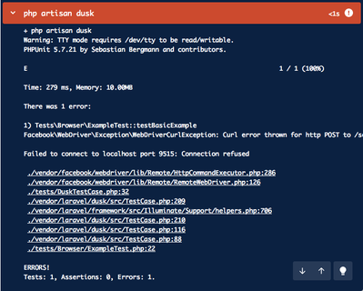

I am trying to setup a Laravel 5.4 project in BitBucket Pipelines, with Laravel Dusk test scripts. However, I can't seem to get a successful build. After fixing several issues and finally getting my build to run my test scripts, I am not stuck at :
How do I get the Chrome Wed Driver to launch and run the test?

Hi @ngitaly, I tried to create a new container for testing using the container link you gave but it was returning me the following error:
Unable to find image 'networld-dusk:latest' locally
docker: Error response from daemon: repository networld-dusk not found: does not exist or no pull access.
So instead, I tried by using the steps described in the link with my existing container that is set up with php7-fpm and is still unable to get my test to run successfully.

Error in my documentation. "networld-dusk" is available on my local becasue I compiled it.
Please use "angelomaragna/networld-dusk" like in
docker run --privileged --name dusk -ti angelomaragna/networld-dusk /bin/sh
