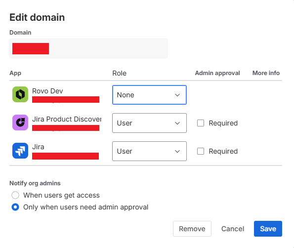

1. User that was trying trigger rovo dev review was the author of that pull request.
2. Jira site has credits for that site as far as I know and Rovo dev is activated from Bitbucket workspace.
But at the meantime I think we managed to make Rovo Dev work by setting a role for Rovo dev in admin.atlassian.com App access settings for our domain.
"Any domain" had Rovo dev role "User".
Our domain had Rovo dev role "None". After changing role to "User", Rovo reviews started to work for all users.
