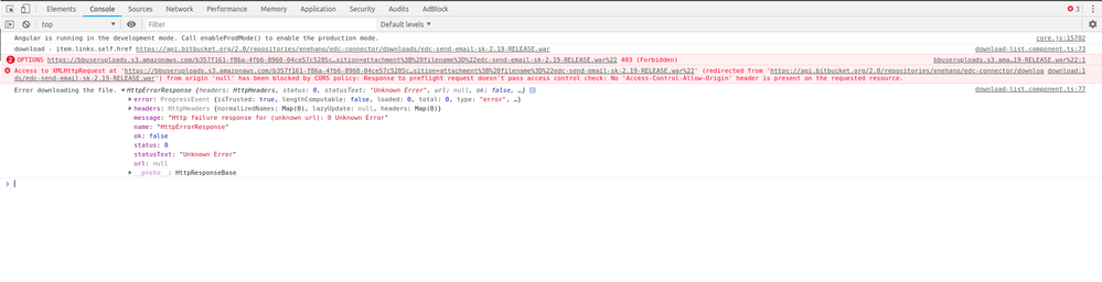

I have created simple page to download file from bitbucket (I have a pipeline which at the end of process upload file to repository download page).
My problem is when try to download file from angular page (I'm using api https://developer.atlassian.com/bitbucket/api/2/reference/resource/repositories/%7Busername%7D/%7Brepo_slug%7D/downloads/%7Bfilename%7D).
After creating GET request to api, the error response reason is 'Response to preflight request doesn't pass access control check: No 'Access-Control-Allow-Origin' header is present on the requested resource.'
As a part of error message is a link to amazon AWS cloud - when I click on the link download file will start.
Could you please help me?
Here is log from my browser ..

It looks as though you have a very solid workflow and automation process going on. The error you are running into is due to the Bitbucket CORS. The simple resolution would be to add a header on your call to include;
Access-Control-Allow-Origin: *

it looks help, but the file is not possible to download yet. At this time I get another error. I have try to add Access-Control-Allow-Origin to Access-Control-Allow-Headers but it not help.
has been blocked by CORS policy: Request header field Access-Control-Allow-Origin is not allowed by Access-Control-Allow-Headers in preflight response.
