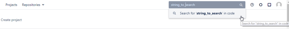

Hello Friends,
I would like to search a string in all the Bitbucket server repositories using Rest API.
I can search the code from the Bitbucket Server "Search Box" but it is not possible if there are multiple strings to search and generate a report.
a common use case would be- search all repositories where a common password is exposed.
Is there any Rest API available or could you suggest any workaround?
