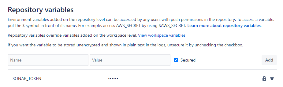

I defined a repository variable :

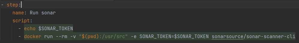

Then I tried using it in my pipeline to pass it to sonarcloud :

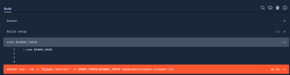

But it seems empty. Echo returns nothing and sonar fails because the variable is not set :
From the documentation, echo $SONAR_TOKEN should write $SONAR_TOKEN in the console because it is a secured variable. It writes nothing.

I tried adding a non-secured variable and echo it the same way, it still prints nothing.
Anyway, from what I understood, secure variables should display their name instead of there value in logs. Here it displays nothing and it seems to be empty when I give it to sonar.
I don't know if it's relevant but I'm using a self-hosted windows runner
