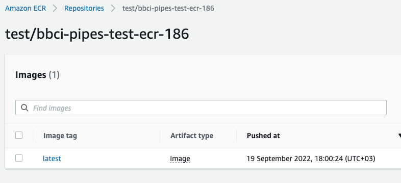

@mgarcia hi. So i tested this case and found no issues.
You can find my config here .
As you can see i have IMAGE_NAME test/bbci-pipes-test-ecr-${BITBUCKET_BUILD_NUMBER} which is equal for my build test/bbci-pipes-test-ecr-186
I successfully pushed image to ECR.
The only case when i received your error: INFO: {'errorDetail': {'message': 'EOF'}, 'error': 'EOF'}\x1b[0m\n\x1b[31m✖ Docker push error: EOF\x1b[0m\n"
was only when docker image name not the same as provided in pipe variables.
In example you built test/bbci-pipes-test-ecr-186 but tried to push to 123456789.dkr.ecr.us-east-1.amazonaws.com/bbci-pipes-test-ecr-186 (without test/ group)
Also our team updated tests to incude case with slashes and will soon release a new patch to include these updates.
Regards, Igor
