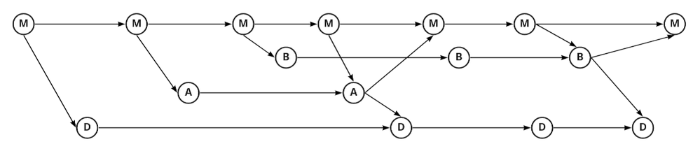

Marek Kon
September 27, 2022
Hi,
I do not know if this is the case with @Deepak S , but I have a problem with PR commits that appear despite the fact that they are already present on the target branch. The situation is shown in the picture below. After updating branch B (M-> B) and creating a PR from B to D, all commits from branch A reappear in that PR.

Vishal Deshmukh
March 13, 2024
Hi Marek,
I am facing similar issue.
My first question is during M->B merge, was it a simple merge or did it shown changes in files which were not modified in B ?
Second Question : Is merging MASTER into Feature branches is a good practice ?
Marek Kon
March 13, 2024
Hi,
re 1. if during the development of a feature on the B branch, changes appeared on the M branch, then such a merge took place, because there were changes on M that were not in B (even sometimes there may be conflicts),
re 2. if the feature branch is created from Master and then merge from Master to is not done, then on pull request to Master, conflicts may arise, which bitbucket itself can not handle and you will have to resolve such conflicts manually locally. So this is not only a good practice, but also a necessity.
