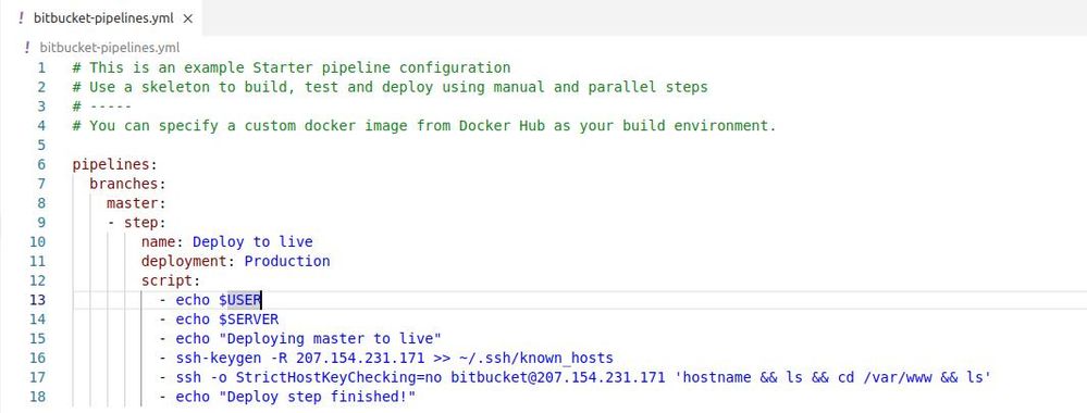

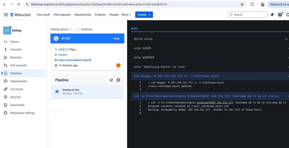

I changed the bitbucket-pipelines.yml as follows:
But when I go to the pipelines section of that repository to see the results, I see a stuck pipeline that is similar to an infinite loop because it does not finish at all!
My timezone is Istanbul/Turkey meanwhile.
