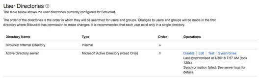

However, I keep getting this error 'Synchronisation failed. See server logs for details.' even though the setup is the same for my JIRA server.

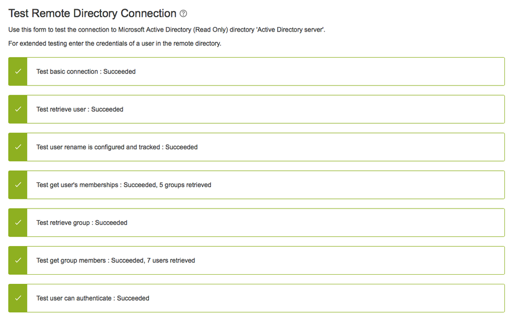

When I test settings with a user, everything works. Below are screenshots of the error messages for synchronization and the test remote connection which is successful.
Screen Shot 2018-04-30 at 4.39.19 PM.pngScreen Shot 2018-04-30 at 4.46.00 PM.png
