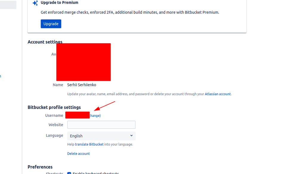

For security reasons, we cannot use other users' credentials, even if they're of a test account, but I think I may see the reason for the 401.
In the curl call you provided in your last reply, you are using
--user Password:<app-password>
However, Password is the Full name of this test Bitbucket account, not its username. The username of a Bitbucket account can be found here (after you log in), next to the field named "Username" (not the "Name"):
Can you check if the curl call works if you use the Username listed in the link above?
Just a heads up, I removed emails and app passwords from your replies, as well as the workspace ids, for privacy reasons.

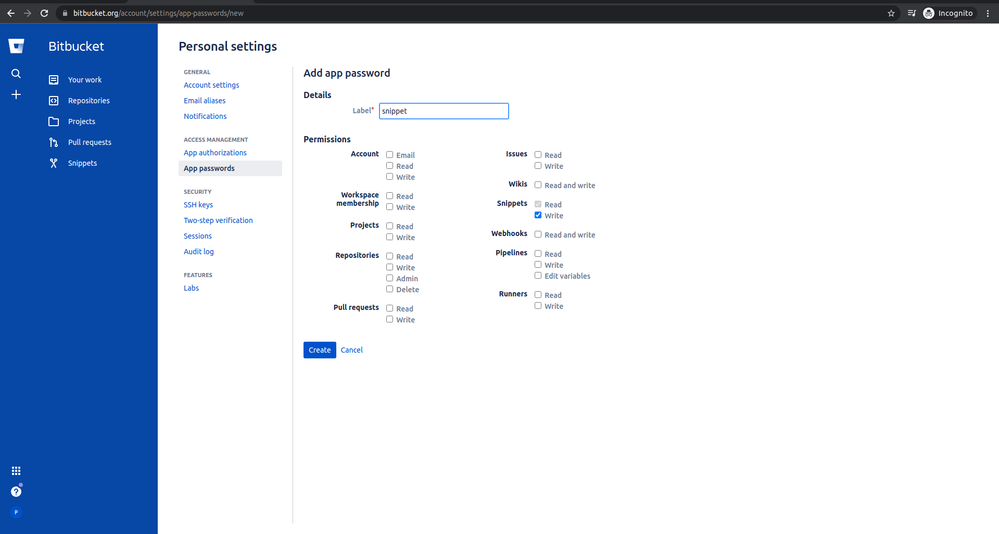

Hi @Theodora Boudale , in initial question I already used username, just missed it with temp repository2022-01-20_08-36.png
